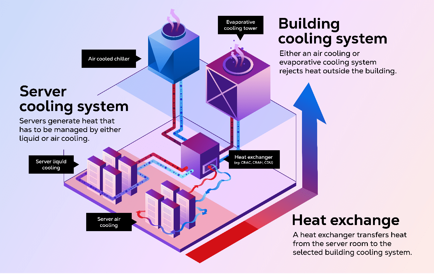

Building cooling system: In addition to the server cooling methods summarized above, data centers are also equipped with systems that remove heat from the facility altogether. The two types of building cooling systems are:
  • Air cooling systems, which reject hot air from the facility.
  • Evaporative cooling systems, which reject water vapor from the facility.
Compared to air cooling systems, evaporative cooling systems can reject comparable amounts of heat while consuming significantly less energy. However, evaporative cooling also drives higher water consumption, so it’s not ideal for data centers located in water-stressed areas. Data center operators must make cooling choices that balance the tradeoffs of energy efficiency and water efficiency. Also, data centers sometimes use non-potable water in cooling systems to help protect the limited supply of drinking water in a community.
Learn more about how cooling choices impact data center water consumption.
Heat exchanger: The equipment that transfers heat from the server room to the building-level cooling system. Different types of heat exchangers include computer room air conditioning (CRAC) systems, computer room air handler (CRAH) systems and coolant distribution units (CDUs).
