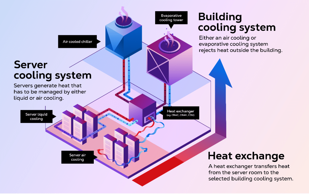

Water
The impact of AI adoption on water consumption is another important aspect of data center sustainability. Though AI workloads leverage “liquid” cooling to cool servers, the technology does not drive significant increases in water consumption. That’s because they use a closed-loop circuit that’s connected to a heat exchanger or coolant distribution unit (CDU).
However, heat still has to go somewhere. After it goes through the CDU, the heat is transferred to a building-level cooling system, which then removes the heat from the facility altogether. At the building level, data center operators choose between two cooling options:
  • Evaporative cooling releases heat from the data center in the form of water vapor.
  • Air cooling, also known as dry cooling, releases hot air from the data center.
Figure 1: Building-Level Cooling System
Evaporative cooling drives higher water consumption than air cooling, but it also consumes much less energy. A global data center operator like Equinix must weigh the tradeoffs of energy and water consumption on a case-by-case basis. For instance, we avoid using evaporative cooling in water-stressed areas, to ensure that more water remains available for use in the community.
As mentioned previously, because liquid cooling at the server level is more efficient, increased adoption of AI workloads may allow us to operate at higher temperatures. This could reduce the need for water consumption in evaporative cooling systems and open the door to use dry cooling in more markets. Also, this may provide more opportunities for us to participate in data center heat export projects, where we capture residual heat from our facilities and make it available for heating homes and businesses in the local communities in which we operate.
