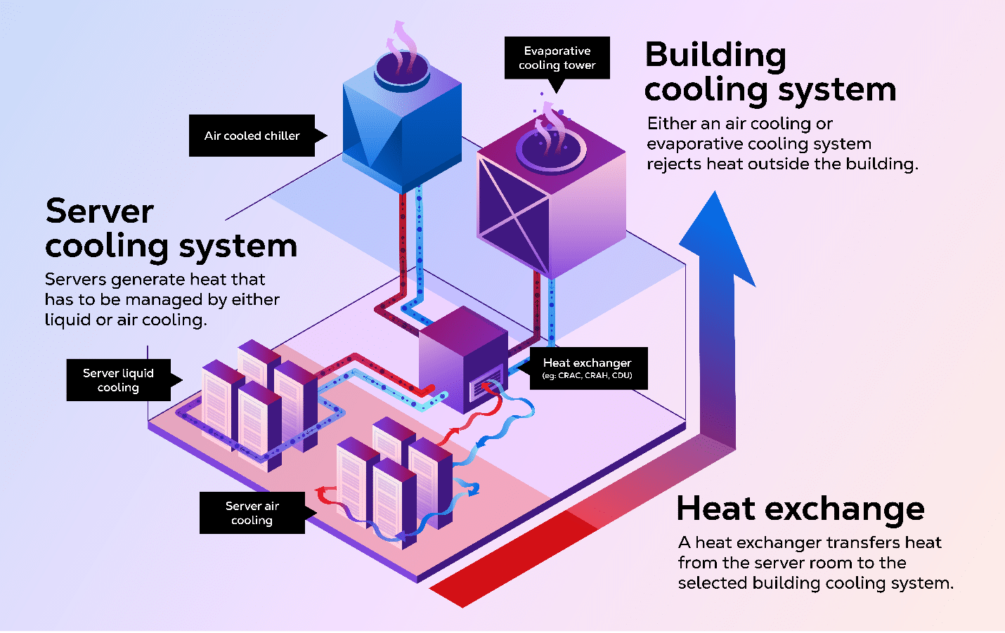

The choice of cooling technology is the biggest factor that impacts how efficiently a particular data center uses water. Specifically, using air-cooled chillers to reject heat outside the building does not consume water. This is why air cooling is the preferred choice for data centers in locations that are experiencing water stress.
The trade-off is that air cooling also uses more energy than evaporative cooling. We aim to balance the benefits of using air cooling in areas that are experiencing water stress and evaporative cooling in places with power-constrained grids.
Data centers require cooling at both the building level and the server level. Evaporative cooling at the building level is not to be confused with liquid cooling at the server level. Liquid cooling uses a small amount of liquid coolant that moves continuously in a closed loop, and this liquid does not evaporate. So, despite what the name might indicate, server liquid cooling has a negligible impact on data center water consumption.

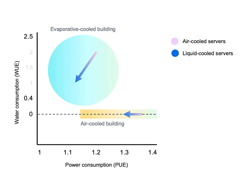

Data center operators use water usage effectiveness (WUE) to measure water efficiency, just like we use power usage effectiveness (PUE) to measure energy efficiency. And just like PUE, WUE is not a perfect metric, but it can be a valuable one if we take the time to understand its nuances.
WUE compares the amount of water consumed in a data center for cooling to the amount of energy consumed by IT equipment. Therefore, it’s measured in cubic meters of water per megawatt hour of energy (m3/MWh). Cooling technology and specific equipment used, weather conditions, operations management, and overall capacity filled at a data center are all conditions that affect WUE in practice.
PUE and WUE are two metrics that must be measured together, because a change in one directly impacts the other. If a data center operator sets aggressive WUE reduction targets without also considering its PUE targets, it could have unintended effects. That’s because the easiest way to reduce WUE quickly is by avoiding evaporative cooling altogether. Since air cooling consumes more energy than evaporative cooling, this move can drive a corresponding increase in PUE. The relationship between PUE and WUE represents the trade-off that data center operators have to balance between energy consumption and water consumption.
Among the limitations of WUE is the fact that not all data center operators report it the same way. If an operator reports only a single WUE figure, you’d have no way of knowing if that figure includes all its data centers, just the ones that use evaporative cooling or just one specific building. At Equinix, we report two different WUE figures: one for our entire data center portfolio and one exclusively for data centers that use evaporative cooling. In 2024, the last year for which complete statistics are available, these figures were .95 and 1.55, respectively.
