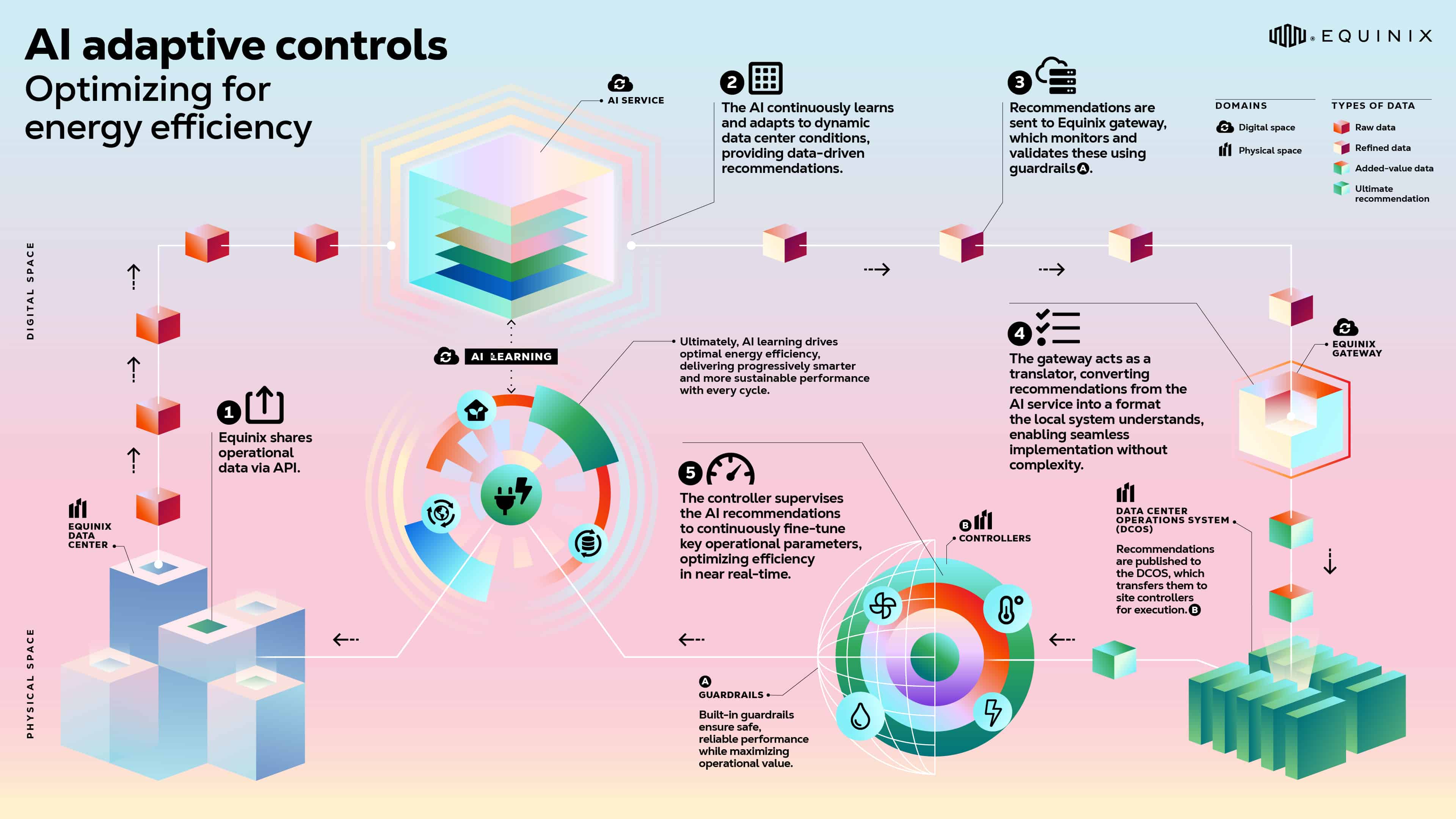

We implemented a machine learning model to guide our physical air-conditioning systems. The model makes small tweaks to our airflow and then observes the results. It works on the principles of reinforcement learning: If a particular tweak leads to lower energy consumption, then the model knows to make similar tweaks in the future.

When the model makes a recommendation, it must pass through an AI gateway:
  • The gateway is responsible for translating recommendations into a format that local systems can understand.
  • It’s also responsible for applying guardrails. It detects if the recommendations would take our data centers outside of safe, reliable operational parameters. If so, it does not pass those recommendations on to local systems.
  • If a recommendation is rejected, the AI gateway provides feedback to the model, so that the model knows not to make similar recommendations in the future.
AI guardrails help us balance the tension between AI innovation and AI safety. This ensures that any optimizations we make will not have unexpected consequences for our customers.

All of the recommendations that our machine learning model makes are based on real-time data that’s collected from sensors throughout our facilities and then shared with the model via APIs. With this kind of visibility into our operational data, the model can predict thermal spikes and adjust proactively.
