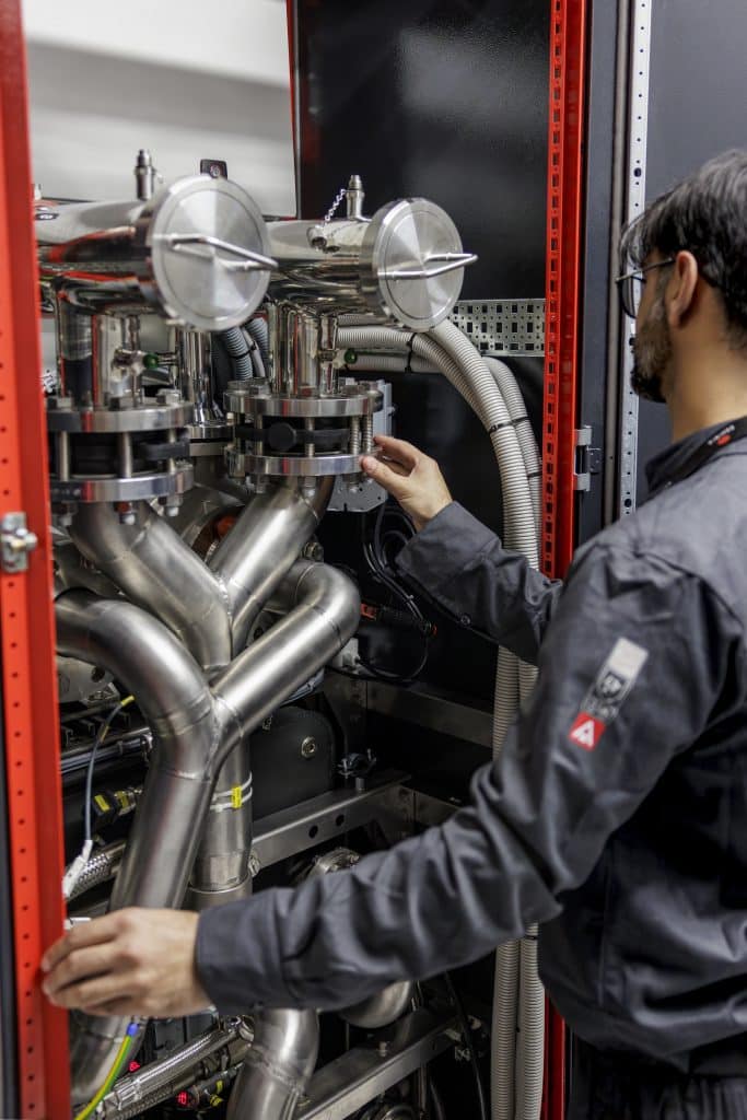

2.    Coolant distribution unit (CDU)
The CDU acts as the central exchange point between the facility and server cooling. Its role is to:
  • Transfer cooling power from the building chiller to the servers
  • Return heat from the servers to the building cooling system, where it’s then rejected from the facility
To do this effectively, CDUs incorporate:
  • The heat exchange plate that efficiently transfers thermal energy between the two loops
  • Pumps that push coolant from the CDU to the server racks
  • Filters to ensure the required level of purity for coolant entering the server racks
  • Sensors to ensure coolant is distributed to the server racks at the right temperature and pressure
To protect servers against unplanned cooling outages, CDUs are typically designed and built for redundancy. This could mean N+1 redundant pumps within a CDU, redundant power connections within a CDU, and redundant CDUs within a facility.
